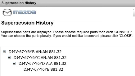

Postprzez darrecki » 14 sie 2025, 14:28
As pictured, B to E are interchargeable. E is latest revision

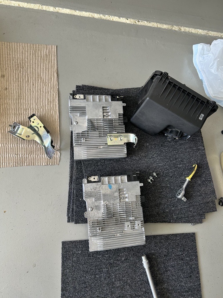

Postprzez afm31 » 3 wrz 2025, 11:05
Today I changed my model "B" to a model "D".
The good news: as expected it is a "plug & play" job – no reprogramming needed.
The (kind of) bad news: it is a pain in the ass to get to all the screws to dismount the DCDC Converter. I have attached a picture how it looks like on my CX3 with the old converter removed.
Now I will keep an eye on the charging voltages if everything is fine now.

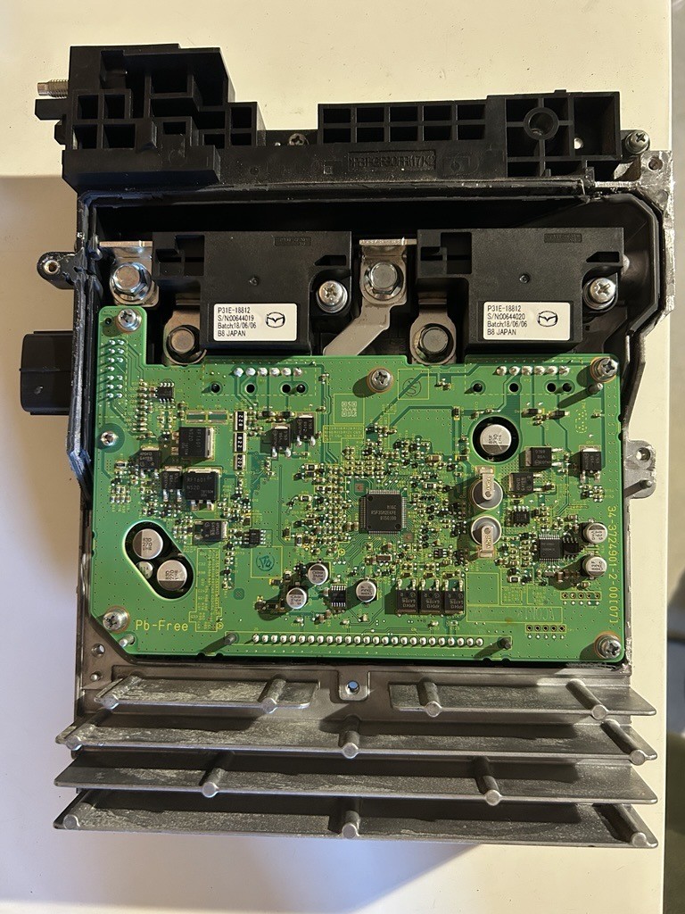

Dopisano 3 Sep 2025, 16:18:
I already started to disassamble the rev "B" DCDC Converter. Wow – that thing is definitely NOT made to be opened or repaired! <lol> Everything is glued and soldered and it takes a lot of special tools and skills.
There a 2 mechanical heavy duty relays inside – I have desoldered one of them to reverse engineer and test. Looks like the are built to switch a lot of amps – maybe they quit working after some time ...

Postprzez krzychun » 4 wrz 2025, 15:54
afm31 napisał(a):Wow – that thing is definitely NOT made to be opened or repaired! <lol> Everything is glued and soldered and it takes a lot of special tools and skills.
That's exactly what I suspected
afm31 napisał(a):Looks like the are built to switch a lot of amps
Definitely above 100A, the scale in Forscan is up to 127A, and it was more...
