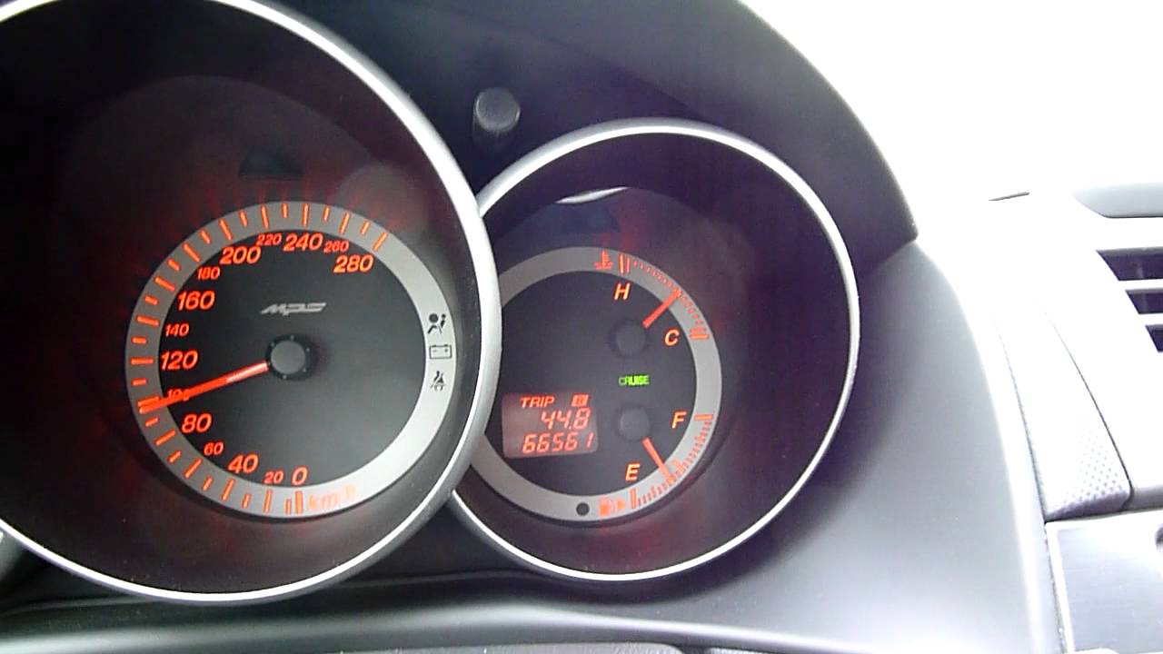

Secondly, check that it has the “Cruise” LED’s on the dash. Do this by going into the test mode of the dash/cluster. Switch off the ignition. Hold the trip zero button while switching the ignition on and keep holding it until test is displayed in the trip meter area. Release the trip meter – test will now change to a number. Press the trip meter button until you get to number 26. The cluster lights up. Check if Cruise is lit. Switch the ignition off to exit test mode.

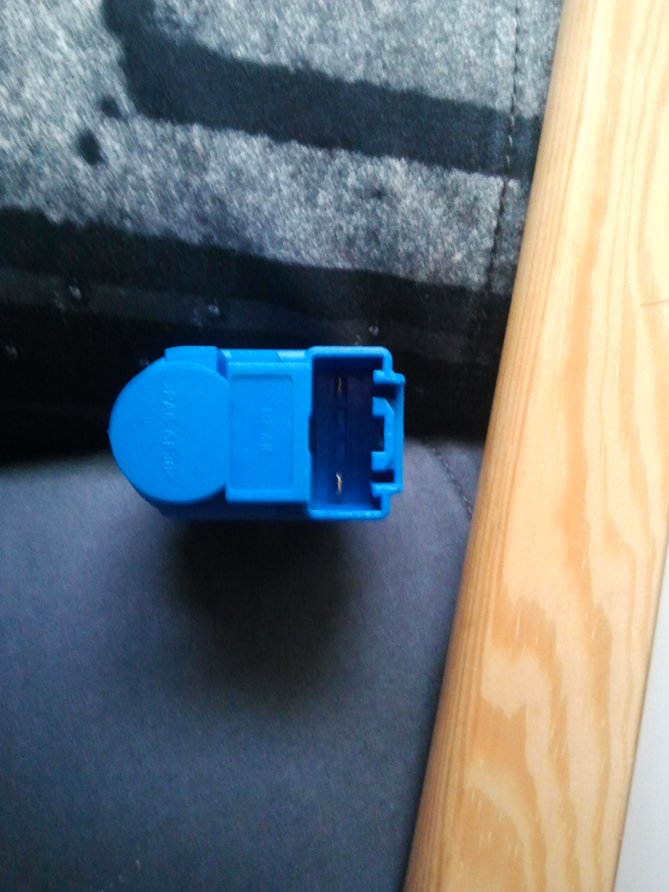

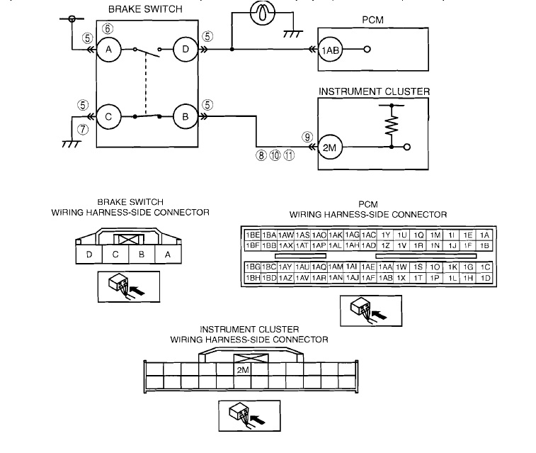

Thirdly, check that the brake switch, located above the brake pedal, has 4 wires.
Once you can answer yes to these questions you are ready to go and get the steering wheel controls and a brake switch.
The part number for the brake switch is BN7N 66 490. R200 at Mazda.

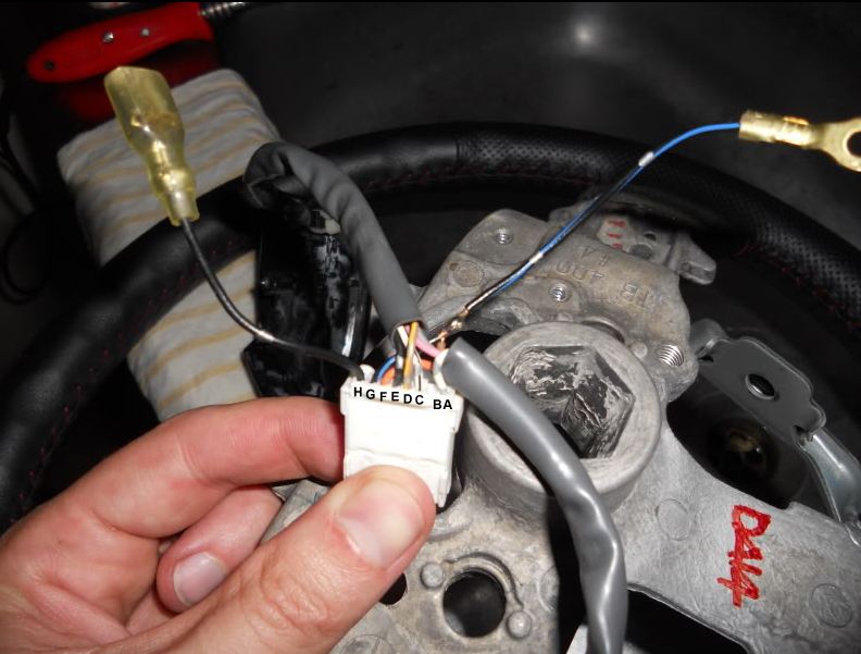

I am going to ignore the wire couloirs as they all differ depending on the steering wheel switches you bought.

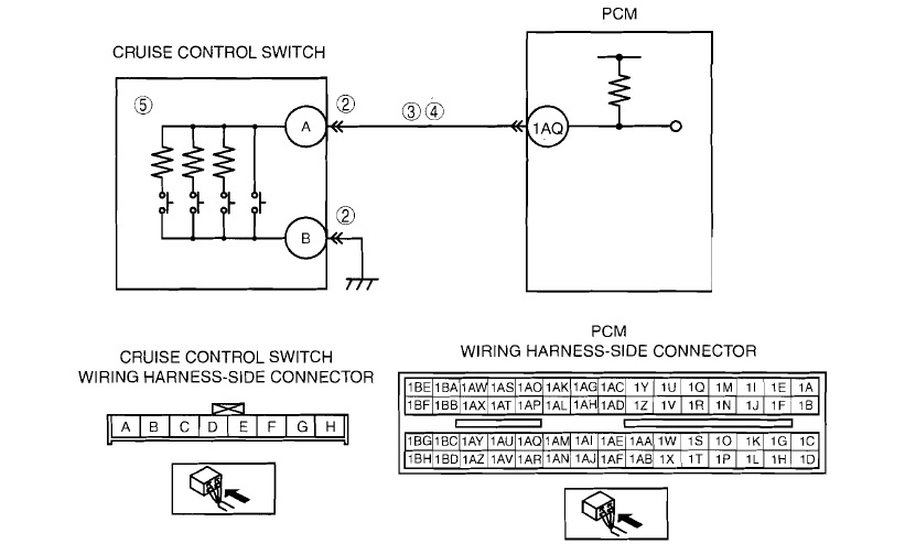

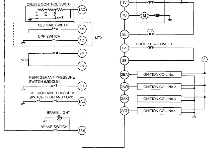

A and B is the C/C buttons. Test this with a multi-meter. Test the resistance wile pressing a button on the C/C panel. C and D is the Audio control buttons. They can be tested in the same way. E and F is the LED’s on the switches. G and H needs to be grounded. The wire at B (one of the C/C wires) needs to be cut and also grounded with H or G. Hence there is no wire at position B in the picture. I soldered it to G as in the image. A and B can be any way round as can C and D. E is the negative of the LED’s and F is the positive. Judge it by wire couloir.

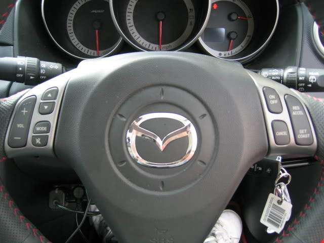

Once the brake switch is installed you are ready to install the steering wheel switches.

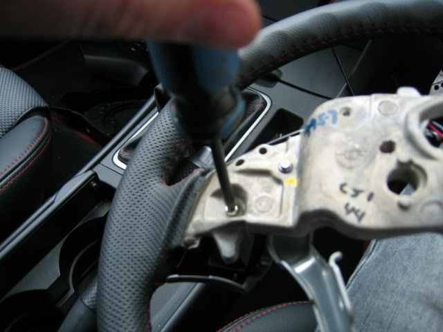

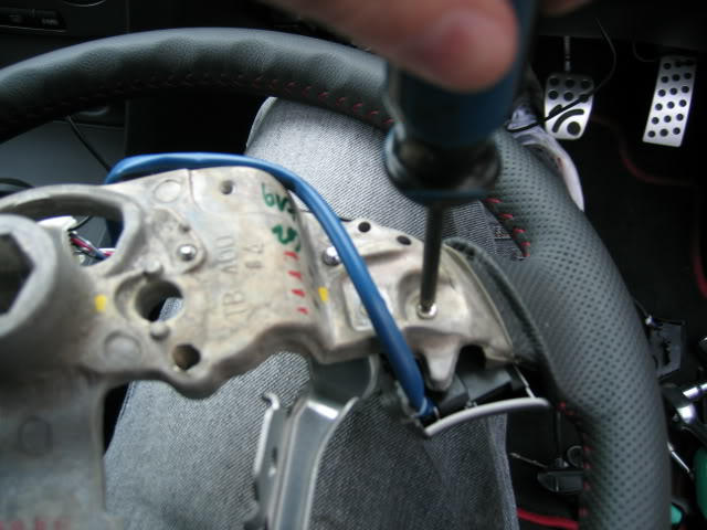

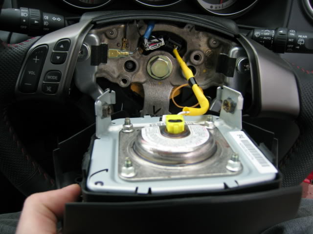

Remove the 2x rubber caps that are on either side of the back steering wheel and remove the bolts with a 10mm socket. Now carefully remove the air bag (centre of steering wheel). Unclip the airbag plug by lifting the black retainer with a small flat screw driver.
Turn the steering wheel to centre.

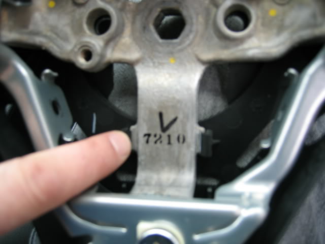

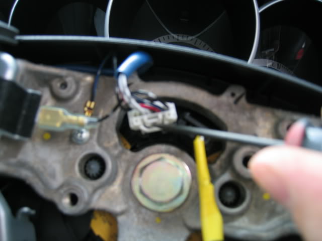

Unplug the standard audio control switch plug and remove the nut at the centre of the steering wheel. You can now remove the steering wheel.
Turn the steering wheel over and remove the two screws holding the back of the steering wheel cover. Once the cover is removed you will be able to see the two screws that hold the audio control switches and the blank cover of the other side in place. Remove these two screws and remove the audio controls.
Now install the new audio and C/C switches on the steering wheel and route the wires round the back and connect the two ground wires.
Install everything in reverse order.
Once done connect the battery. Switch on the ignition and make sure the switches work. “Cruise” should appear on the cluster when the on/off switch is pressed.
Voila!!!! You have factory C/C.

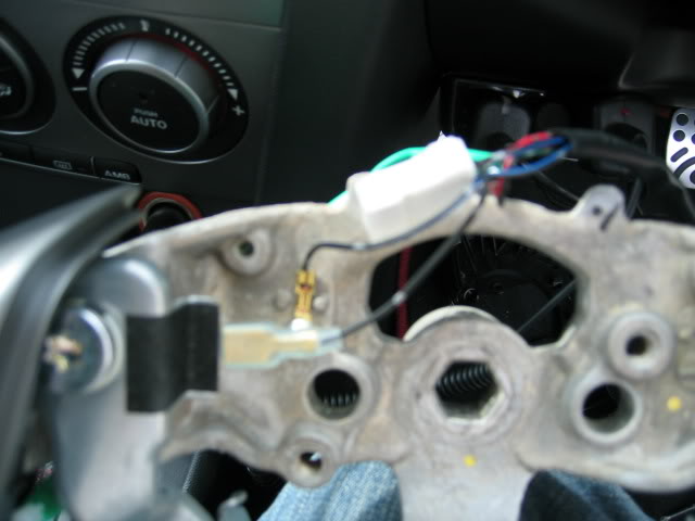

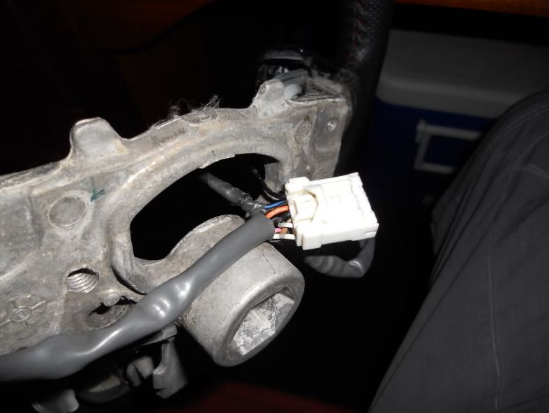

Reszty zdjęć nie wrzucałem, bo są podobne do innych. Tylko wtyczka ma tu znaczenie.
EDIT: Tak, to działa. Wystarczy uziemić pin A lub B razem z tym, przykręcanym na "ucho" do kierownicy i mamy działający tempomat z przyciskami od M6. Z innymi będzie identycznie.

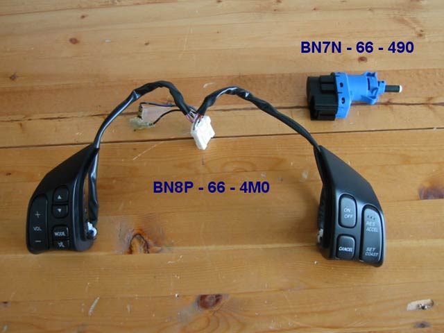

Jeżeli jesteśmy już pewni że posiadamy wersję poliftową to musimy zaopatrzyć się w 2 elementy które obsługują tempomat.
– BN7N-66-490 – czujnik położenia pedału hamulca
– BN8P-66-4M0 – przyciski sterujące radiem i tempomatem razem z listwą
Wygląd powyższych elementów przedstawia zdjęcie:
Czujnik kosztuje około 50zł, natomiast przyciski najlepiej kupić z kompletną kierownicą ponieważ same są słabo dostępne. Koszt kierownicy zaczyna się od około 50zł.

5. Zmiana czujnika położenia pedału hamulca.

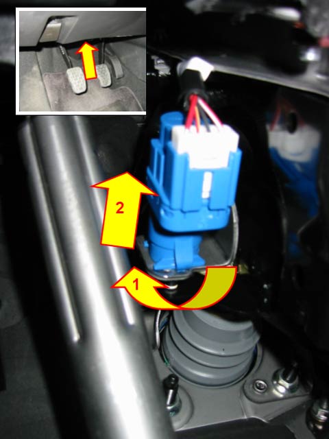

– Czujnik znajduje się zaraz nad pedałem hamulca, pod kierownicą, wewnątrz przestrzeni między pedałem a kolumną kierownicza
– Dojście do czujnika jest tragiczne, mi zajęło kilkanaście minut by ogarnąć jak należy się do tego zabrać. Po fakcie jest to banalna czynność.
– Przyglądnij się jak jest zamontowany czujnik.
– Przekręć czujnikiem w lewo, należy kręcić z wyczuciem by nic nie urwać, przy kręceniu czuć opór bo jest on ciasno zamontowany
– Wyciągnij czujnik z mocowania i odepnij od niego kabel.
– Wepnij kabel w nowy czujnik i wsadź w mocowanie.
– Przekręć czujnik w prawo.
– Powinien być zamontowany tak jak poprzedni.

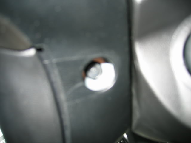

– Zdemontuj dwie zaślepki po obu stronach kierownicy.
– Przy pomocy klucza nasadowego 10 odkręć znajdujące się w otworach śruby.

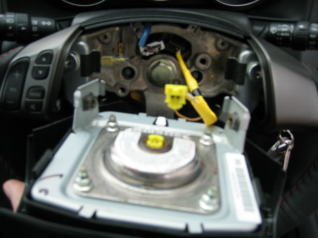

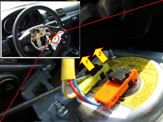

– Ostrożnie wyciągnij poduszkę powietrzną – będzie mieć podpiętą 1 wtyczkę kablową jeżeli to wersja EU (żółta wtyczka),
albo dwie jeżeli US(Zółta + pomarańczowa).
– Przy pomocy płaskiego śrubokrętu podwadź czarny adapter.
– Następnie wyciągnij całą wtyczkę kablową.
– Odłóż w bezpieczne miejsce z dala od przestrzeni pracy.
7. Demontaż kierownicy.

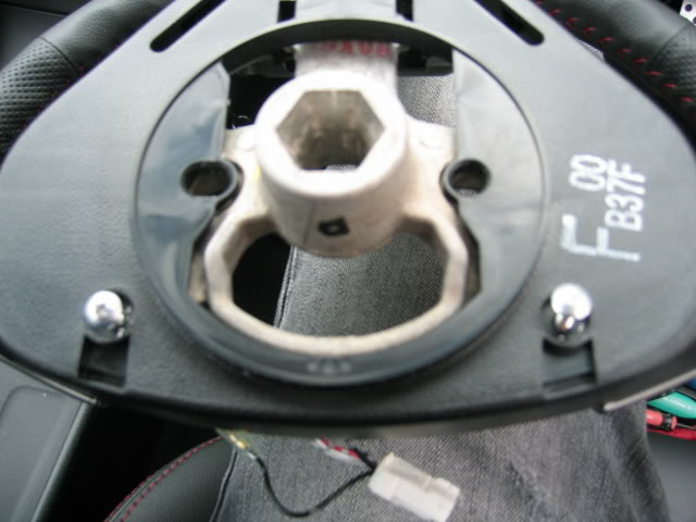

– Wypnij wiązkę kabli od przycisków na kierownicy.
– Przy użyciu klucza nasadowego 21(*1) odkręć śrubę mocującą kierownicę.
– Po odkręceniu śruby, kierownica powinna gładko zejść z kolumny kierowniczej.
– Wypnij wsuwki od klaksonu i masy.

– By wyjąć przyciski i wiązkę odkręcamy dwie srubki z tyłu kierownicy przy pomocy śrubokręta krzyżakowego.
– Następnie odpinamy dwa zatrzaski z przodu kierownicy.
– Zdejmujemy plastik maskujący tył kierownicy
– Odkręcamy śrubkę po każdej ze stron gdzie znajdują się przyciski przy pomocy śrubokręta krzyżakowego.
– Delikatnie wysuwamy plastiki by nie uszkodzić wrażliwych plastików.
– Montujemy zestaw przycisków z sterowaniem tempomatem.

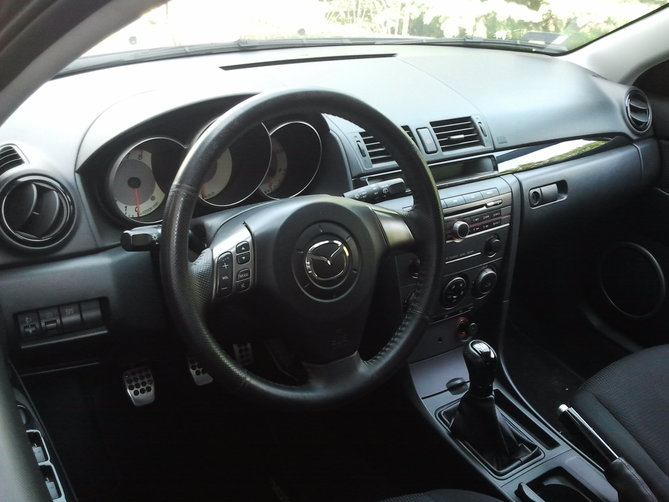

Sterowanie tempomatem przy pomocy przycisków zamontowanych na kierownicy.
Uzbrajamy go przyciskiem ON/OFF – na prawym zegarze deski zegarów (temperatura, paliwo) pojawia się napis CRUISE w kolorze żółtym – tempomat jest uzbrojony
Uruchamiamy go przyciskiem SET/COAST – na prawym zegarze deski zegarów (temperatura, paliwo) pojawia się napis CRUISE w kolorze zielonym – tempomat jest włączony i aktywny
Teraz możemy:
Przyspieszać – RES/ACCEL
Zwalniać – SET/COAST
Przyśpieszać na chwile – pedał gazu (wciskająć przyśpiesza, po odjęciu wraca do zadanej prędkości)
Anulować tempomat – CANCEL lub naciśnięcie pedału hamulca lub naciśnięcie pedału sprzęgła (procedura zmiany biegu)

Wymagane elementy do montażu tempomatu.
6. Demontaż poduszki powietrznej.
8a. Jeżeli mamy już gotową kierownicę z nowym zestawem przycisków sterujących to montujemy ją w miejsce zdemontowanej starej. Stosujemy metodę montażu odwrotna do demontażu.
8b. Jeżeli mamy tylko przyciską z wiązką to przechodzimy do punktu 9.
9. Demontaż przycisków z wiązką.
Teraz możemy:

Powyżej fotka czujnika do którego wchodzi kostka pod którą nie podłączymy tempomatu – wchodzą do niej tylko dwa kable.

Były zdjęcia z montażu to ja udostępnię trochę wycinków schematów.
Całym sercem tempomatu jest PCM
Jak widać na zdjęciu sterowanie tempomatem jest rezystancyjne, czyli na zasadzie dzielnika napięcia. Dodatkowo zdjęcie pokazuje, że również do PCM dochodzi nam sygnał nie tylko z przycisków tempomatu, ale i z pedału hamulca oraz pedału gazu, dlatego tak ważny jest elektronicznie sterowany gaz bo nie trzeba dokładać mechanizmu pracy linki.
Tu mamy schemat czujnika hamulca. Skrajne przewody to plus z akumulatora i sygnał do PCM, wewnętrzne masa i sygnał do zegarów. Występują wersje gdzie są dwa czujniki (tak jak u mnie), różni się tylko tym, że mamy dwa oddzielne czujniki, a nie jeden, do których dochodzą kostki z dwoma przewodami jeden jest odpowiedzialny za obsługę żarówki i PCM drugi natomiast za obsługę zegarów. Jeżeli ktoś posiada wersję z jednym czujnikiem do którego dochodzi kostka z czterema przewodami należy sprawdzić czy z tego czujnika wychodzą cztery piny. Jeżeli tak to czujnik jest kompatybilny z tempomatem, jeżeli są tylko dwa piny to należy wymienić go na powyższy. Oczywiście instalacja analogiczna jak w przypadku dwóch czujników. Może występować wersja gdzie jest jeden czujnik i dochodzi do niego kostka z dwoma przewodami. Oznacza to, że producent nie przewidział możliwości montażu, ale nic straconego postaram się to opisać na końcu postu.
Na sam koniec schemat samych przycisków i kostki w kierownicy. Z przycisków od tempomatu będą wychodzić cztery przewody, dwa są odpowiedzialne za podświetlenie i raczej będą zmostkowane z przyciskami od sterowania radia dwa pozostałe to sterujące (na schemacie A i B) jeden musi być wpięty w kostkę w skrajny pin A(obojętnie który) drugi podłączony do masy.
