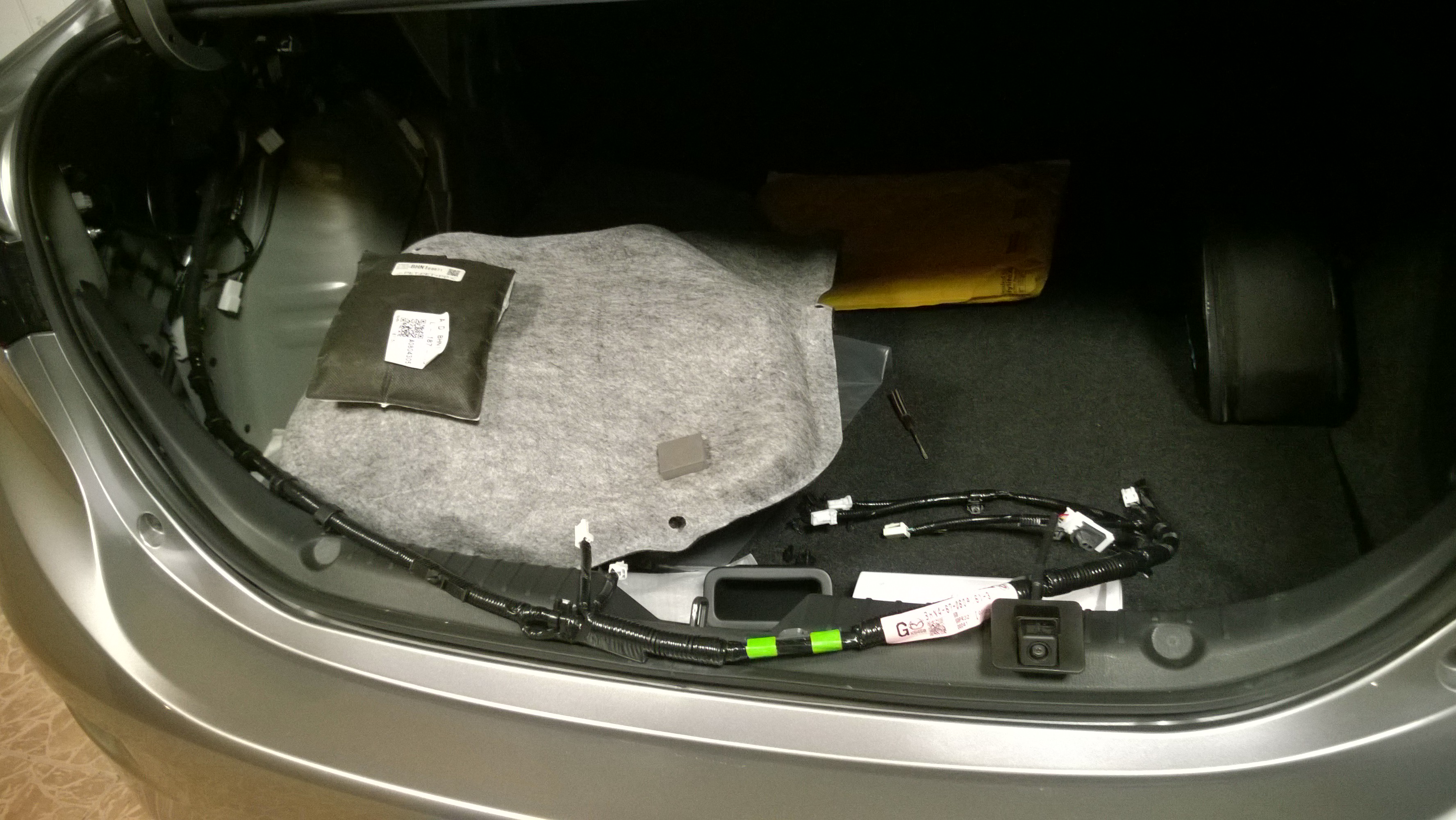

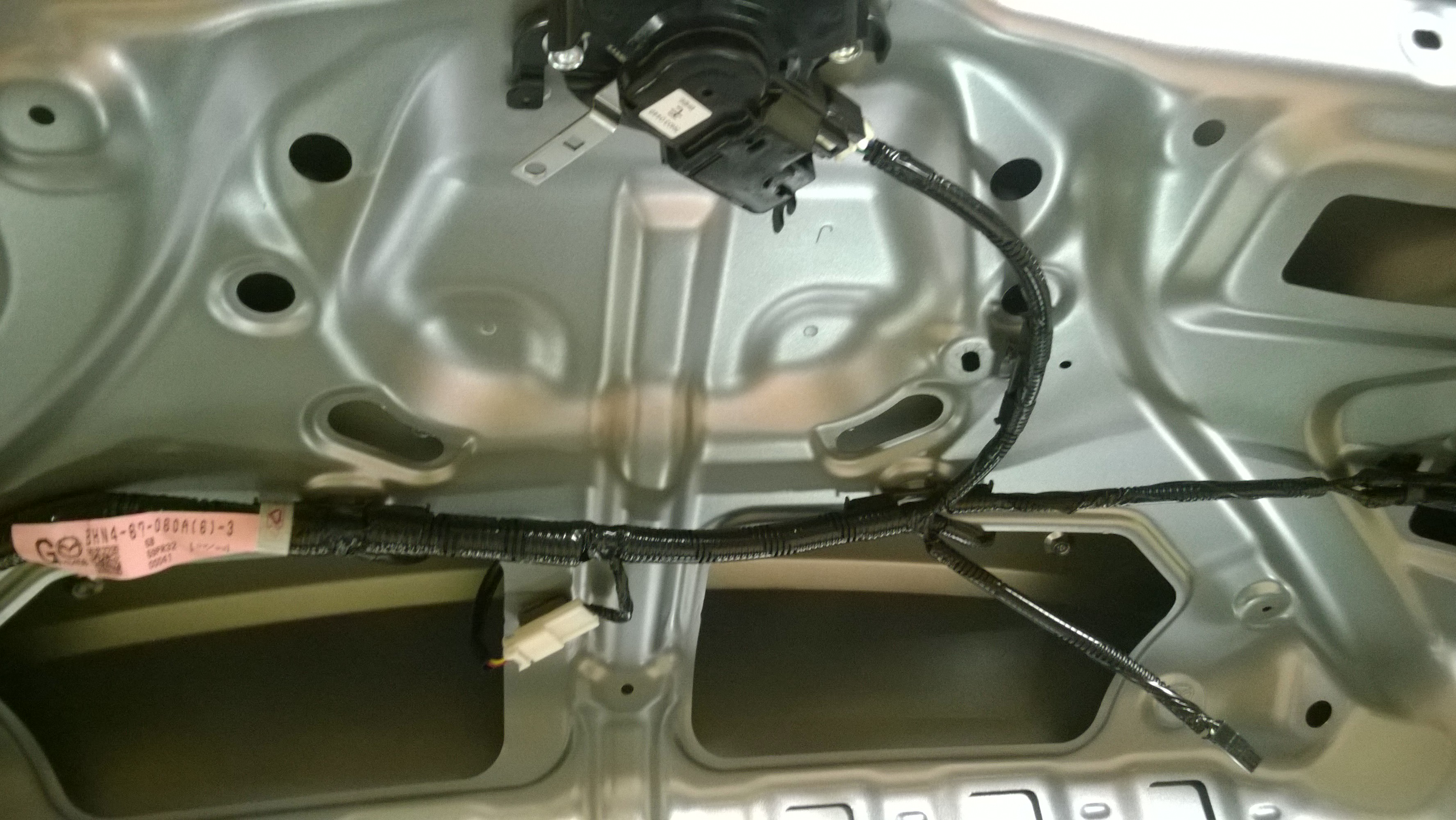

Where is your boot release button? Inside the car or on boot lid? If inside the car, the extra plug is for switch on the lid. Otherwise I have no idea, but I can check if you provide any plug pictures.

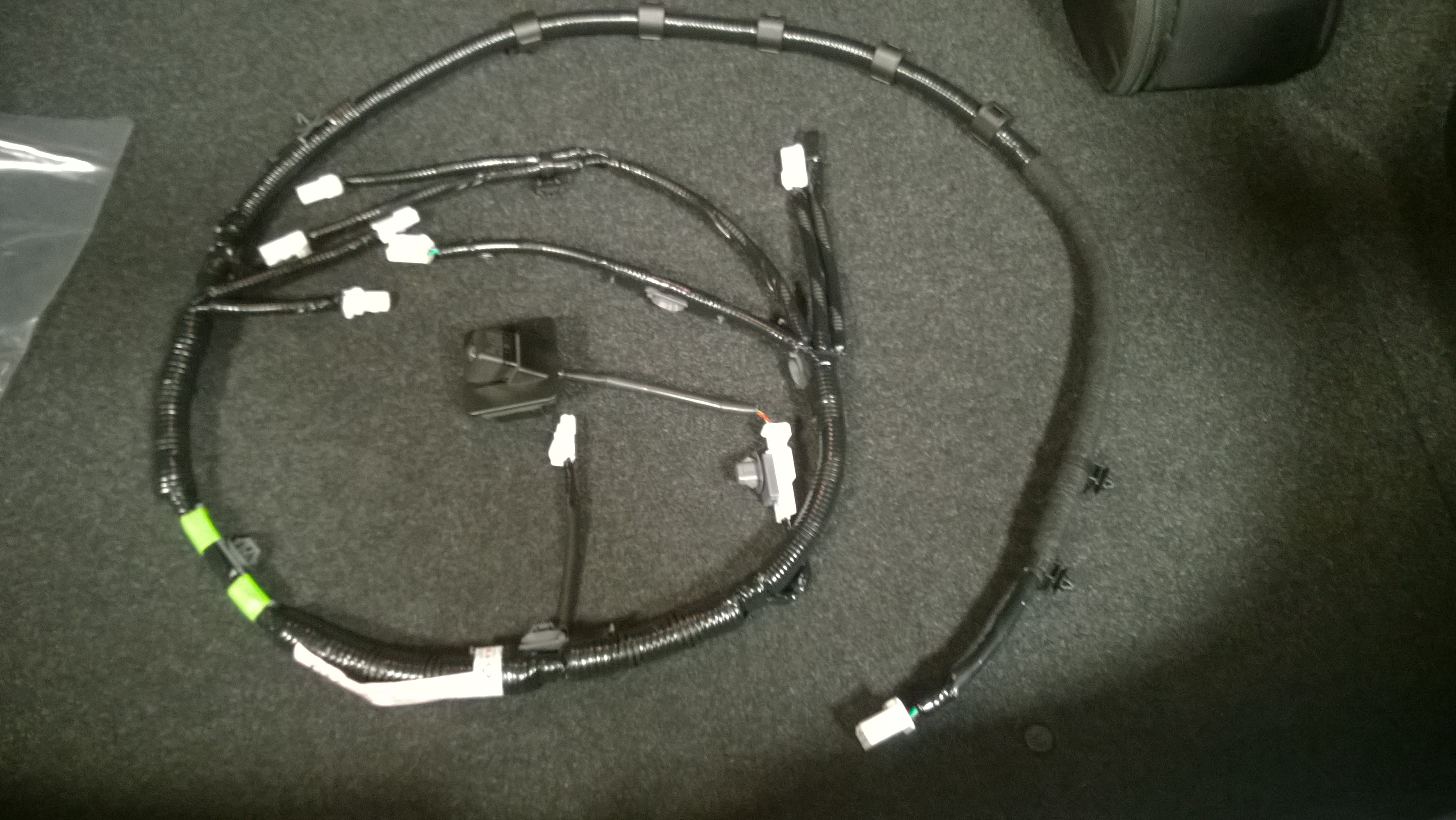

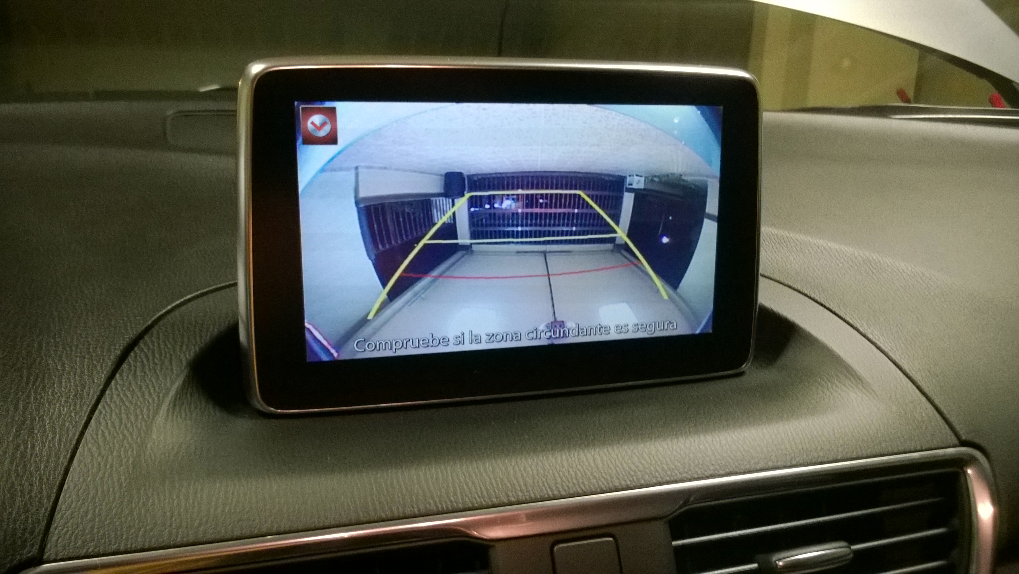

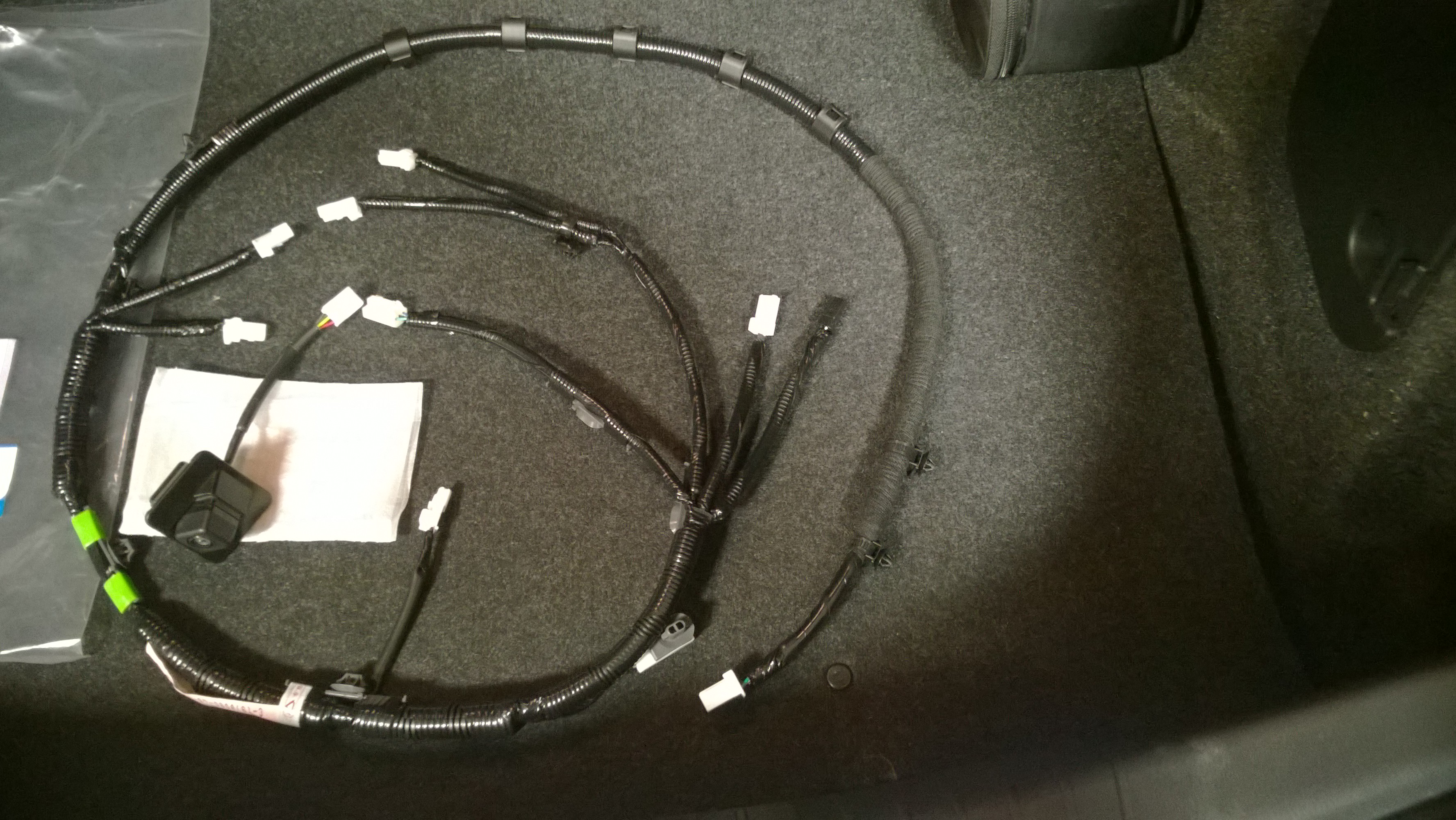

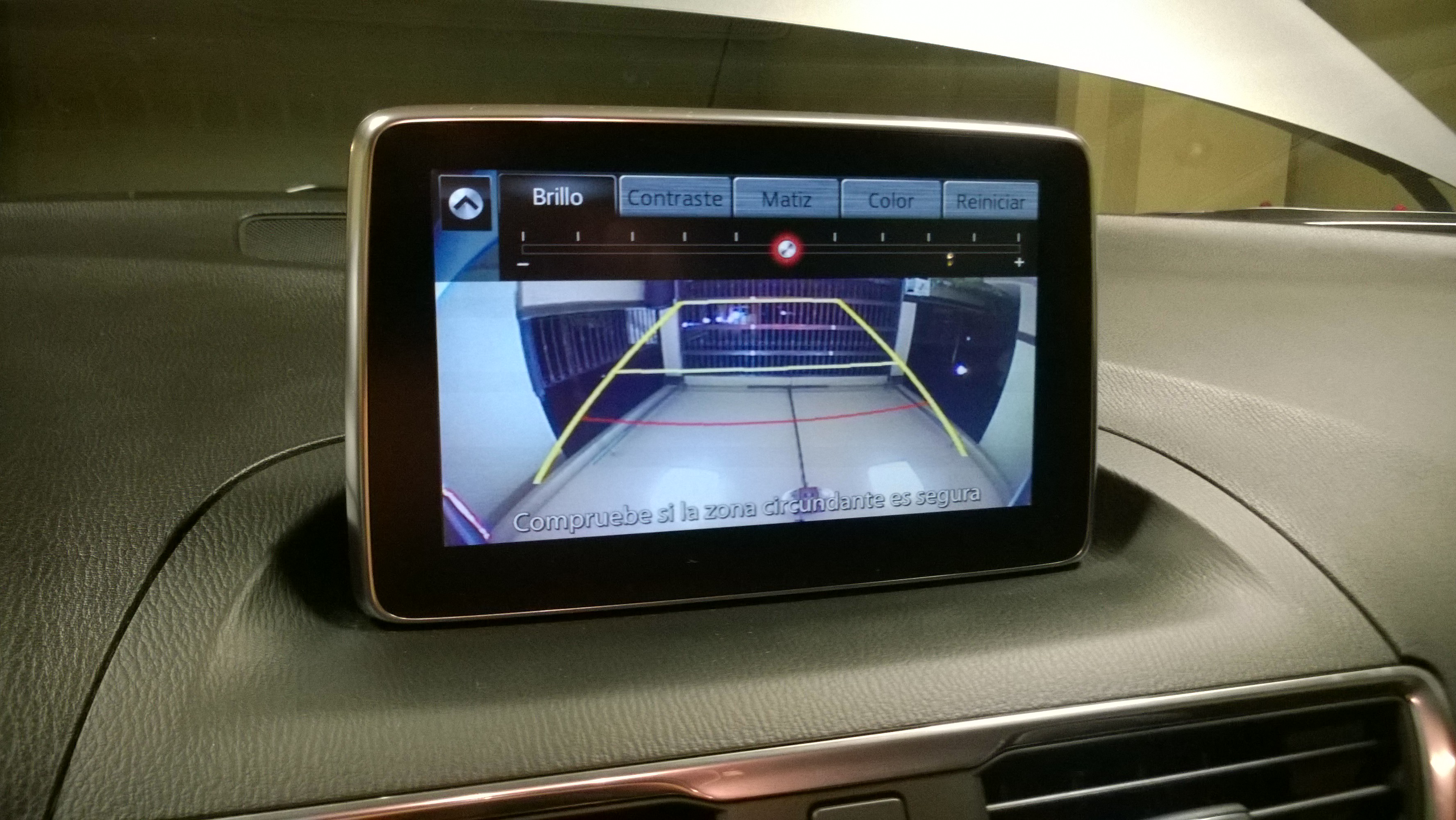

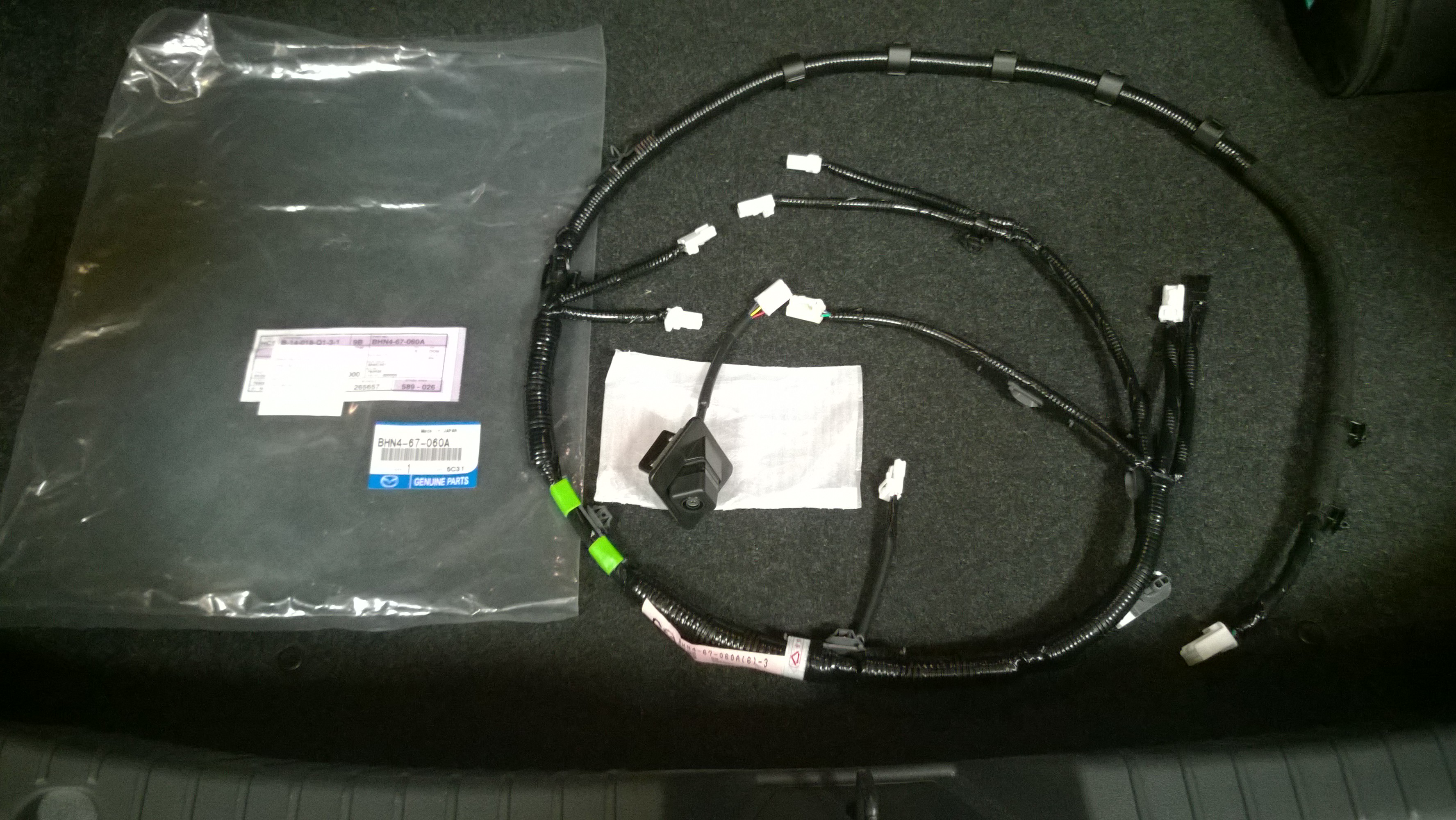

hi I install the harness and fit perfect, I have inside the cabin trunk release button and in the key control too, works perfect as the camera too, only a free connector that its show in the pictures i add.
can be connect something else in the connector, its like your harness.
thanks darrecki and wojtek.
regards.

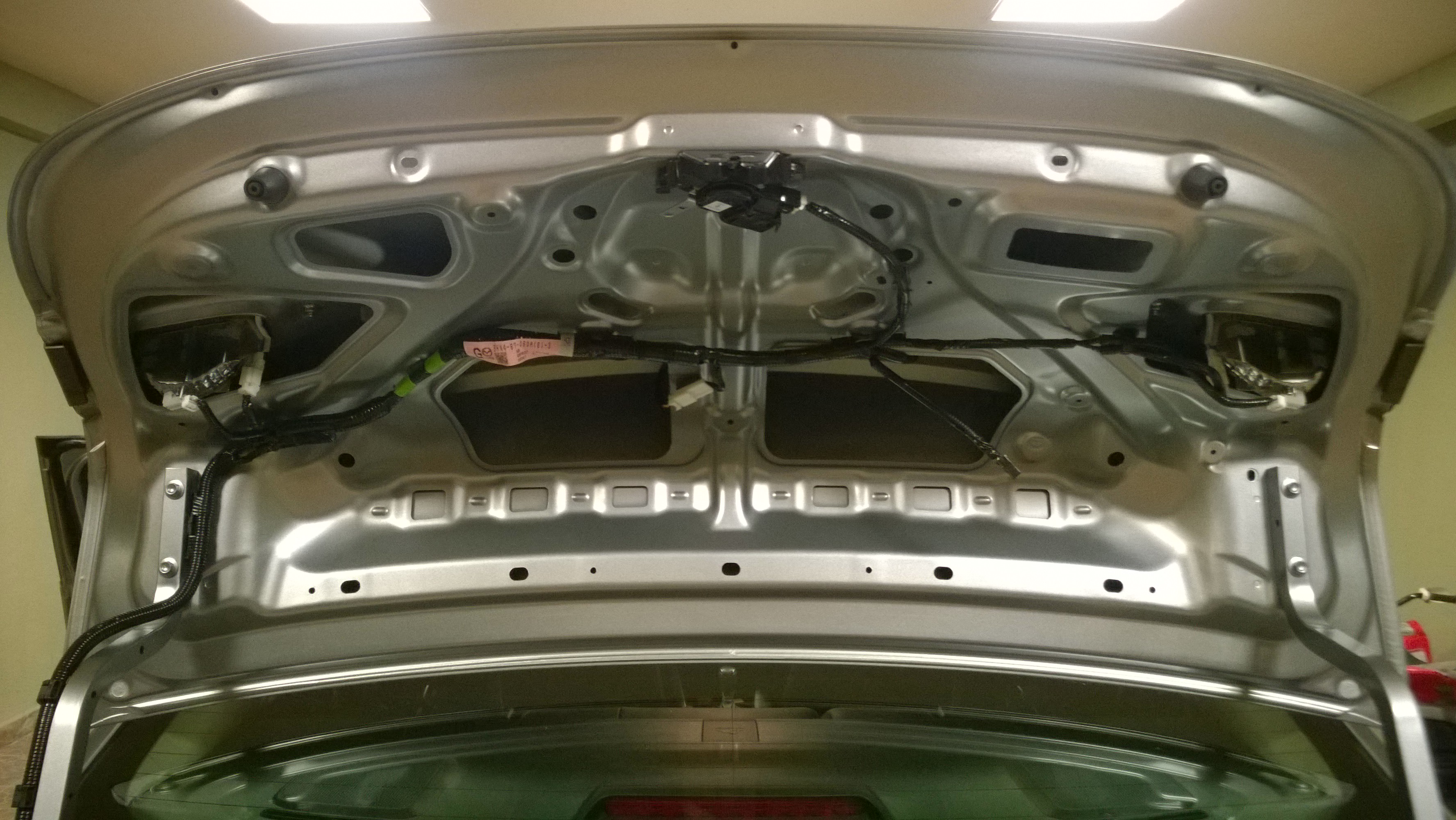

Postprzez darrecki » 11 maja 2016, 10:01
That plug is for boot opener located at lid, next to camera. Having that harness you can always add it in future :) European cars do not have boot release switch inside the cabin. Glad we could help.

Postprzez mazda3mxli » 11 maja 2016, 10:25
thanks darrecki, i appreciate your comments and help as wojtek too.
as my mazda its from japan i think thanks why has the release button inside.
one thing to tell its i ask dealers in mexico and usa and they simply not know what replace harness can help. Im glad that i found this forum and look that the harness you share can be a solution to the people that want to install the rear camera in the sedan.
fux the price for the harness was as describe below
Shipment Details
Part Number
Part Name
Price
Quantity
Total
BHN4-67-060A
HARNESS NO.2 REAR
$41.45
1
$41.45
Subtotal:
$41.45
Shipping (USPS – First Class):
$4.60
Total:
$46.05

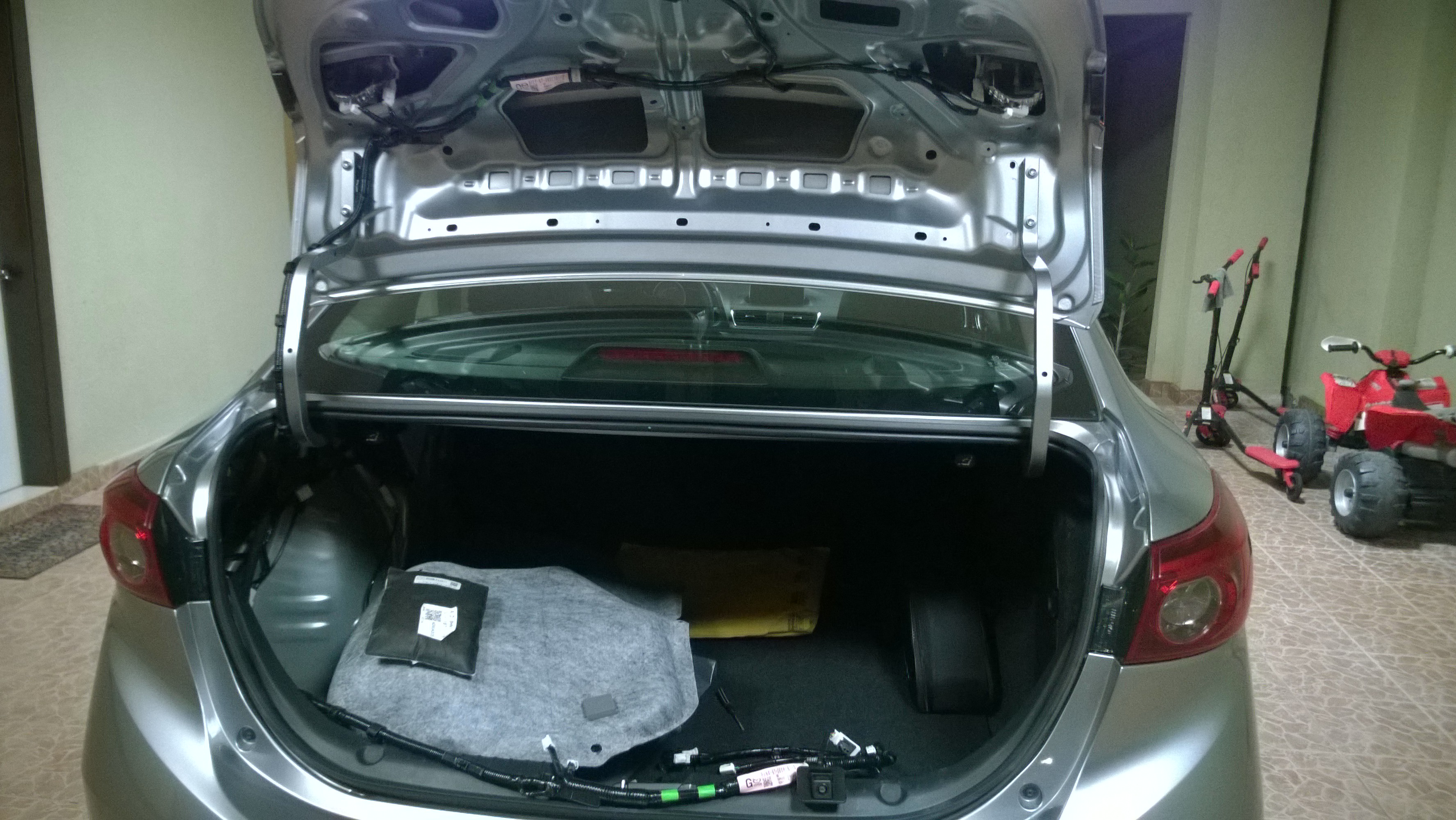

I just retire the original harness and replace with the one that darrecki share BHN4-67-060A
it was plug and play.
hope this help.
regards

Boot release switch location depends on the market, not where they are made.
