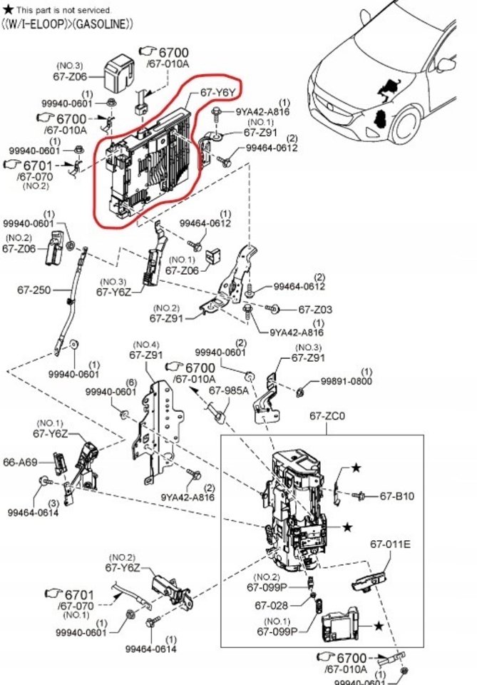

Glad to hear that there are still other people out there who do not resign on that cursed i-eloop technology!
I am afraid we have to stick to DJ4V-67Y6Y line – accordingly to the Mazda service manuals, there are 2 different types of DC/DC converters out there. One is a downstep converter, converting 12-25V to 12V in i-eloop cars which are equipped with the 25V capacitor.
The other one is an upstep converter converting <12V up to 12V for i-stop cars without capacitor. It is used to keep board electronics running, while the voltage drops when the car is restarted after an i-stop stop.
I assume that both types are built in likewise cases – and maybe that is the reason the complicated DJ4V is much more expensive than other 67Y6Y models.

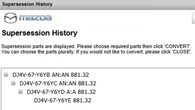

wstrzalka PM me your VIN, I'll check compatibility with higher revisions.
But in my opinion DJ4V-67Y6Y A/B/C/D are the same. When Mazda make some improvements, they always change last digit. For example, shocks for my car are rev F, all revisions looks the same and are interchangeable. Of course they behave differently.
afm31 if your car is EU/UK/Aus, i can check your VIN as well. I do not have access to american market info.

I too believe that the models DJ4V-67Y6Y A/B/C/D are interchangeable without any problems.
But – DAY0-6Y6Y and DA7A-67Y6Y – they look the same – but I guess they are different models. (maybe i-stop without i-eloop?)
As pictured, B to E are interchargeable. E is latest revision

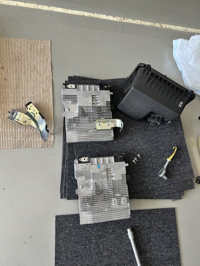

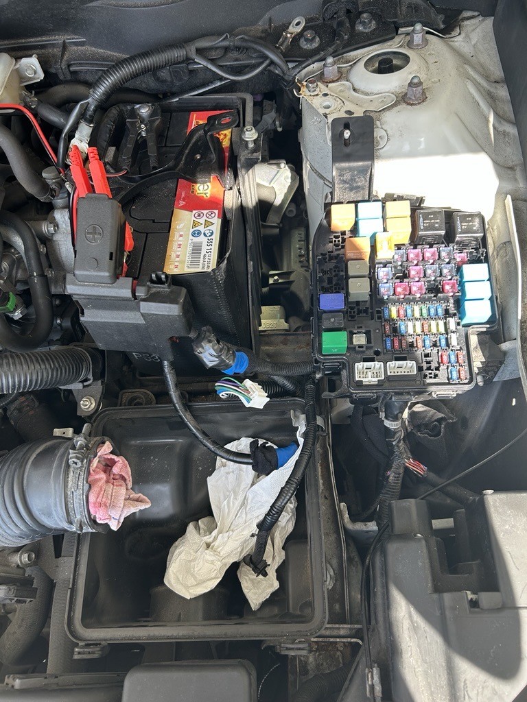

Today I changed my model "B" to a model "D".
The good news: as expected it is a "plug & play" job – no reprogramming needed.
The (kind of) bad news: it is a pain in the ass to get to all the screws to dismount the DCDC Converter. I have attached a picture how it looks like on my CX3 with the old converter removed.
Now I will keep an eye on the charging voltages if everything is fine now.

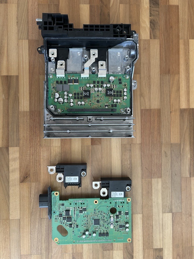

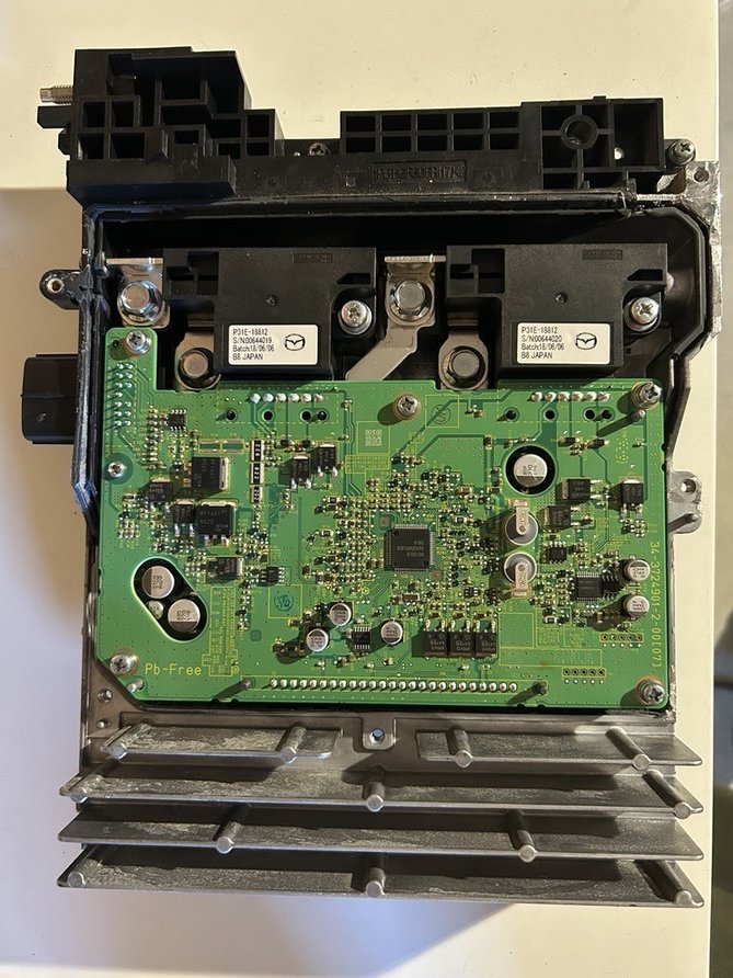

I already started to disassamble the rev "B" DCDC Converter. Wow – that thing is definitely NOT made to be opened or repaired!
Everything is glued and soldered and it takes a lot of special tools and skills.
There a 2 mechanical heavy duty relays inside – I have desoldered one of them to reverse engineer and test. Looks like the are built to switch a lot of amps – maybe they quit working after some time ...
Everything is glued and soldered and it takes a lot of special tools and skills.There a 2 mechanical heavy duty relays inside – I have desoldered one of them to reverse engineer and test. Looks like the are built to switch a lot of amps – maybe they quit working after some time ...
afm31 napisał(a):Wow – that thing is definitely NOT made to be opened or repaired!Everything is glued and soldered and it takes a lot of special tools and skills.
That's exactly what I suspected
afm31 napisał(a):Looks like the are built to switch a lot of amps
Definitely above 100A, the scale in Forscan is up to 127A, and it was more...
