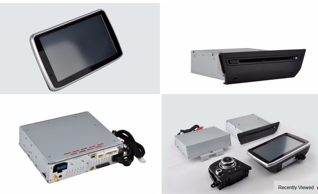

Follow your document about installing the Russian Controller and how to connect my Android phone to the Mazda LCD via HDMI/AV cable (yes, by using Google Translate)
I can understand how to install the Controller but until the step of installing HDMI>AV cable to the car, there has no document (or I can't understand it) – as you can see in this picture below
1. Connect my phone to HDMI cable –> OK
2. Plug the HDMI cable to the Convertor box –> OK
3. From the output of the box, plug the 3 RCA lines to –> OK
And then, where will we plug the other side of this 3 RCA lines to? Plug it to the controller (NOT)? To the CMU?
Can you please help me, some picture or wiring diagram is appreciate
Looking forward to your message
Thanks & Bets wishes,
BlackRed
BlackRed

BlackRed napisał(a):And then, where will we plug the other side of this 3 RCA lines to?
Check wiring diagram:
1. Cut yellow (Video) and connect into socket:
Next... You should connect controler with CAN
After you should cut audio lines and separate for: left signal, right signal and 2 GND
Don't forgret connect audio module with AUX:

@Wojtek & @dnf: Many thanks for your help and first of all, so sorry to say that I have not much knowledge about car wiring system
As I know from the post of @Wojtek is the wiring diagram for the Russian Controller, right?
– connect video + can bus + L/R audio signs
So first, we need to put the Controller in place.
And second is wiring the RCA jacks from the output of HDMI2AV box to the car. I don't know how can I do with this 2nd step, seem that below is the result after this 2nd step?
– Video signal –> Video socket
– Audio signal –> L+R audio socket
– AUX? How can I find this socket/port?
Output of the HDMI/AV converter has 3 RCA connectors. One yellow for video and white and red for stereo sound. You have to cut the end of those cables (cable have to be long  enough – it depends where you want to put the converter and it should be 1.5-2.5 meters). Each cable have two wires in it – the main signal wire and gnd wire that is wrapped around signal cable. You have to separate those cables – first of all you have to get rid of plastic cover of the cable, next you separate gnd wires and twist them to get one wire, next you get rid of cover of signal cable. You can see the procedure of catting the cables in this video
the same thing you should do with all the cables. Now you have to disassembly car LCD/CMU. You have to connect video in this connector.
You can already have cables in marked places like I was and then you have to connect to this existing wires using this connector below or cut some part of the wires shield and twist cables together (of course you have to use some tape to secure the connection).
If you don’t have cables you have to buy pins and put them into connector (remember that before putting pins to connector it should be prepared by unlocking it safety mechanism)
For the audio cables you should disassembly shield on the right side of the passenger sit – there is audio unit with connector that interest you. You have to install pins on your four audio cables (2 signals and 2 gnd’s). When installing pins you can use Heat-shrinkable pipes
Just like when installing video pins you have to remember to take off safety mechanism in connector.
That is all for audio/video cables.
Controller cables have to be connected to other connector next to connector of video cables – most of the cables because some have to be connected to AUX detection line in audio unit. O this picture you casn see connected video cable on the left and controller cables on thr right
the AUX cable is near the audio cables in audio unit (you can see this white cables cut in the middle)
Is this clear for you?
