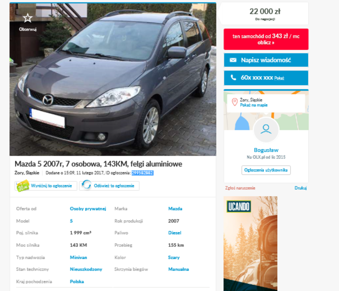

Mazda5 2.0 ON, 2007, (olx: 299582882), 22.000 zł, Żory.
