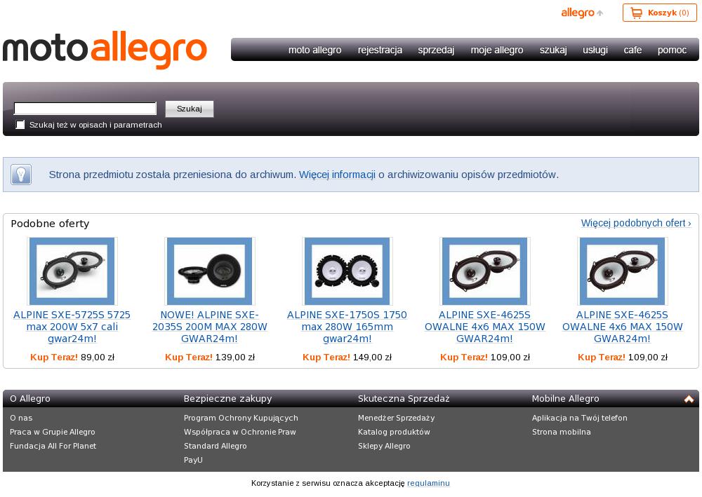

http://moto.allegro.pl/alpine-sxe-5725s-5725-max-200w-5x7-cali-gwar24m-i2119524131.html
