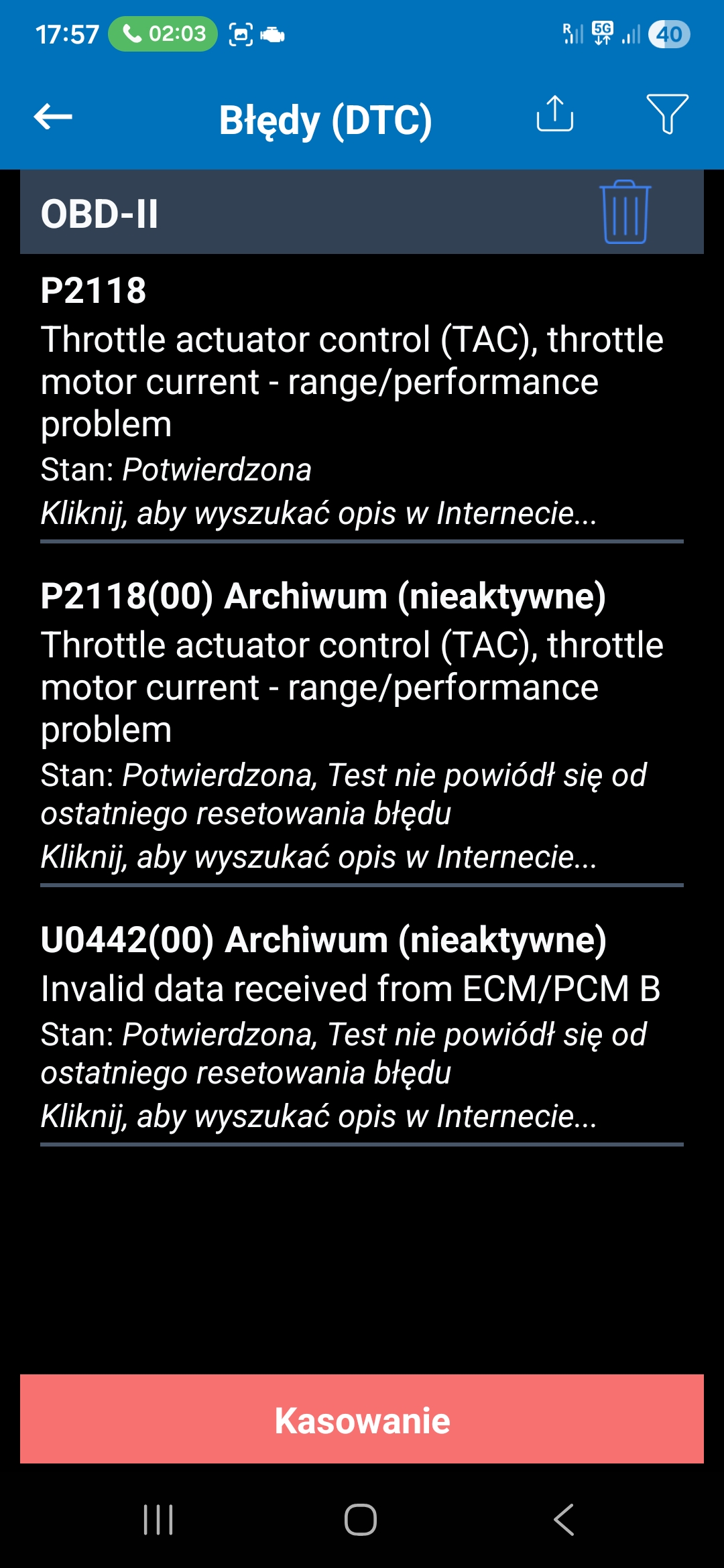

Witam wszystkich,
Mam problem z autem silnik diesla 2.2 175KM błąd P2118. Takowy wyskakuje raz w tygodniu, po usunięciu auto jeździ normalnie. Miał ktoś z tym już doczynienia?

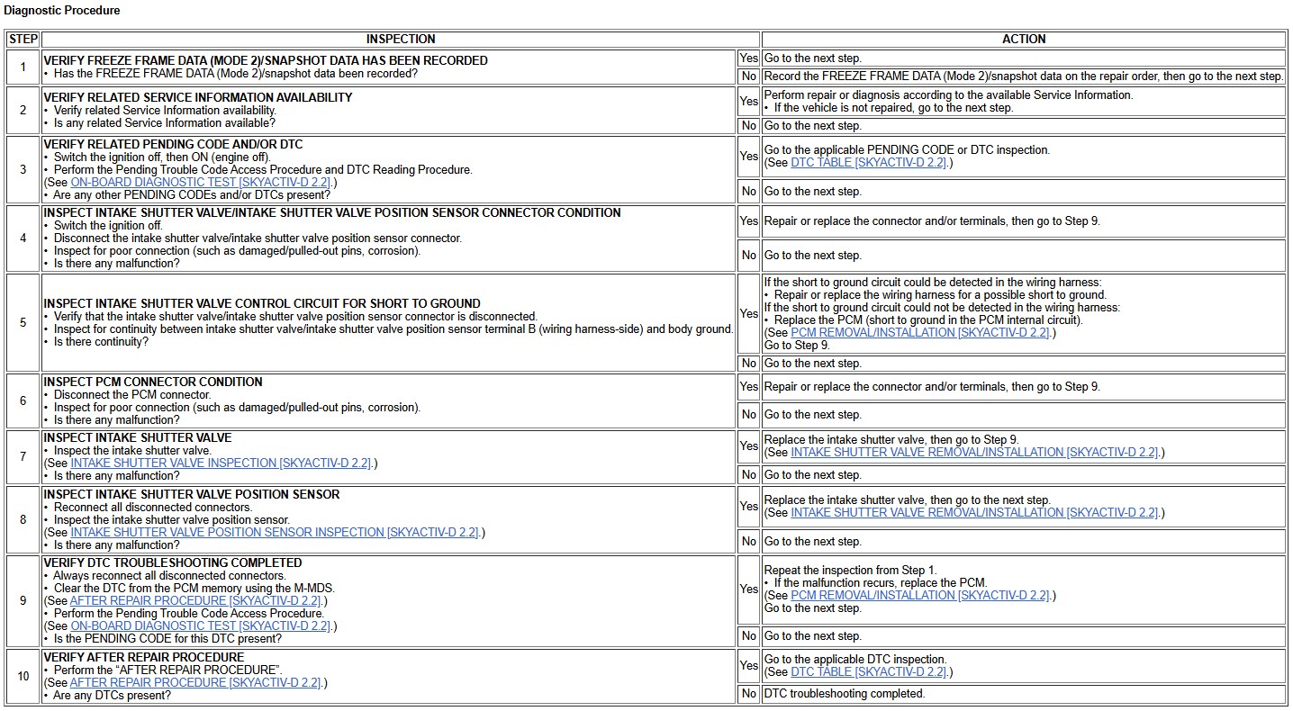

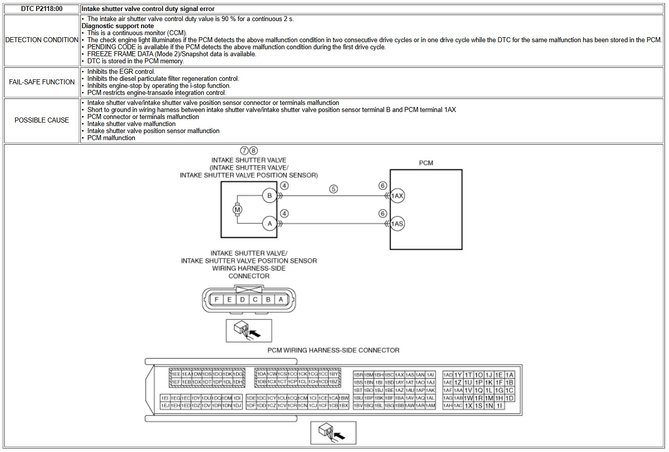

Postprzez darrecki » 6 gru 2025, 23:15
INTAKE SHUTTER VALVE INSPECTION [SKYACTIV-D 2.2]
Resistance inspection
1. Disconnect the negative battery cable.
2. Remove the engine cover.
3. Disconnect the intake shutter valve connector.
4. Inspect the resistance between intake shutter valve terminals A and B.
Intake shutter valve resistance (specification)
0.3—100 ohms [20 °C {68 °F}]
• If not within the specification, replace the intake shutter valve
INTAKE SHUTTER VALVE POSITION SENSOR INSPECTION [SKYACTIV-D 2.2]
PID/DATA Monitor Inspection
Note
• Because the intake shutter valve position sensor is integrated in the intake shutter valve, replacing the intake shutter valve position sensor includes replacement of the intake shutter valve.
1. Connect the M-MDS to the DLC-2.
2. Switch the ignition ON (engine off).
3. Access the PID/DATA monitor item ISV_ACT and ISV_DSD
4. Verify that the ISV_ACT monitor value conforms to the ISV_DSD monitor value.
• If not as verified, replace the intake shutter valve.
