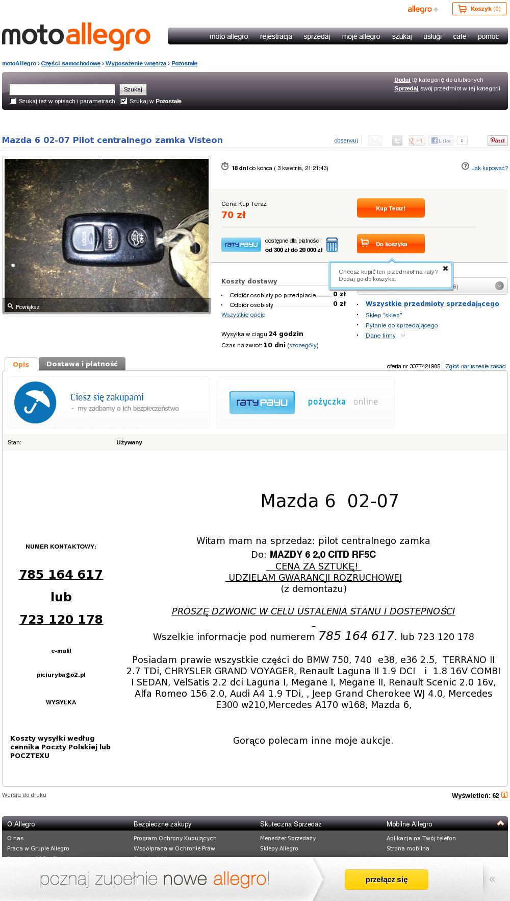

http://moto.allegro.pl/mazda-6-02-07-pi ... 21985.html
