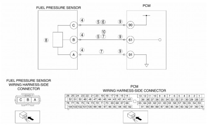

Postprzez smile » 15 sie 2014, 16:54
DTC P0192
Fuel pressure sensor circuit low input
DETECTION CONDITION
• The PCM monitors the input voltage from the fuel pressure sensor while the engine is running. If the input voltage from the fuel pressure sensor is less than 0.4 V, the PCM determines there is a malfunction in the fuel pressure sensor circuit.
Diagnostic support note
• The MIL illuminates if the PCM detects the above malfunction condition in the first drive cycle.
• FREEZE FRAME DATA is available.
• The DTC is stored in the PCM memory.
POSSIBLE CAUSE
• Fuel pressure sensor malfunction
• Connector or terminal malfunction
• Short to GND in wiring harness between fuel pressure sensor terminal C and PCM terminal 90
• Open circuit in wiring harness between fuel pressure sensor terminal C and PCM terminal 90
• Short to GND in wiring harness between fuel pressure sensor terminal B and PCM terminal 61
• Fuel pressure sensor signal and GND circuits are shorted each other.
• PCM malfunction

Postprzez tomaszek3 » 29 sie 2014, 09:39
Witam ponownie
Została sprawdzona instalacja i niby wszystko jest ok, jest tylko tak ze miedzy A a C jest opór 170 om czy to jest prawidłowe, została założona druga listwa i na razie chodzi , czy będzie ok?
